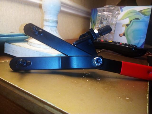

Re: belts (again).
Just brought one of these under £12 delivered keep under seat with breaker bar and sockets to get belt case off can do belt at side of the road .

Has been maxi tours wrote: Wed Sep 18, 2019 6:22 pm Just brought one of these under £12 delivered keep under seat with breaker bar and sockets to get belt case off can do belt at side of the road .Image
I purchased something similar to that and it buckled upon the first use - total waste of money - spend a little more money on a reliable holding tool
