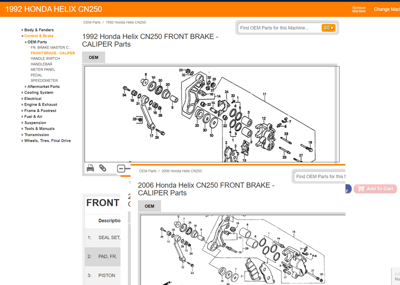

Just a caution, the CN250 used two different brake callipers during it's life, not sure of the change over date but be careful if buying a repair kit. I think either calliper will fit.
Re: HONDA HELIX PROJECT HAS LANDED !
GrahamH wrote: Mon Sep 07, 2020 2:59 pm Just a caution, the CN250 used two different brake callipers during it's life, not sure of the change over date but be careful if buying a repair kit. I think either calliper will fit.
Interesting... how did you discover this? I was under the impression that the same caliper was used throughout, certainly from 1986-1997 which covers the machines I've owned. I've only ever seen one version of the repair kit, and when I bought genuine Honda pistons, Silvers informed me that there was only one piston listed.

I'm not sure when the brake calliper was changed but there have been two different types. I tend to look on Bike Bandit for part numbers and have copied screen dumps for the 1992 and 2006 Helix. The part numbers listed are different for each year but maybe the pistons and seals are interchangeable. I think they mount on the front fork slightly differently and am pretty sure the brake pads are not the same. In any case worth checking when ordering spare parts.

The bloke I ordered my caliper refurb kit through sent me this picture and asked to select which one was mine as the two different models have different sized pistons
Mine is the one on the left and the kit cost a fiver more for my caliper model ( of course)

Pandrop wrote: Sun Sep 13, 2020 12:24 am The bloke I ordered my caliper refurb kit through sent me this picture and asked to select which one was mine as the two different models have different sized pistons
My 87 helix has the one on the left and my 91 fusion has the one in pic 2. Honda must have had 2 different suppliers of brake components. A bit like they have with cars. Funny last week i went to the parts supply for some rotor prices as the garage said i would be up for replacement soon big ridges etc. The vin number was given and the parts guy gave me 3 options. All different diameters? The 4WD is only 6 yrs old. I will be checking the diameter personally before order as too not get it wrong. Or i could be a mug and take it to the dealer and get charged a $1000 dollars to do the job
