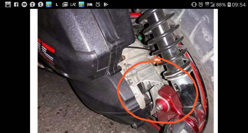

I'm on tip toes and using the one foot method. I'm thinking of getting some rear shock lowering brackets, reports are it's about a 1½" drop and I seen them on a 2018 Forza 300 being auctioned on eBay last month from Scarborough.
Anyone on here fitted them yet?

I read a post regarding a similar mod for the XMax 300 which didn't turn out well although, to be fair, I don't know the full story.
https://advrider.com/f/attachments/broken-png.1443985/

Will both stands work properly?

Argyll wrote: Wed May 01, 2019 3:06 pm I read a post regarding a similar mod for the XMax 300 which didn't turn out well although, to be fair, I don't know the full story.
Need to login to see it.
Capt. R Swipe
Posts: 741
Joined: Sat Mar 22, 2014 4:17 pm
Current Ride: 2023 Forza 350 YamT7
Location: Devon
Re: 2018-2019 Honda Forza Lowering Brackets
Post by Capt. R Swipe »
I'm not an engineer and to my eyes that lowering bracket looks as if it would act like a lever. The physics doesn't look right there....... perhaps bluebottle or an engineer will explain the physics for us........

Just got a reply from the seller of the Forza 300 pictures above that had the lowering brackets fitted.
hi
yes thats where they came from the only problem was making sense out of biker bits themselves, very good product though. No i left the forks alone you could also buy some shorter shock for the rear. all stands ok unaffected.
good luck
Aaron
