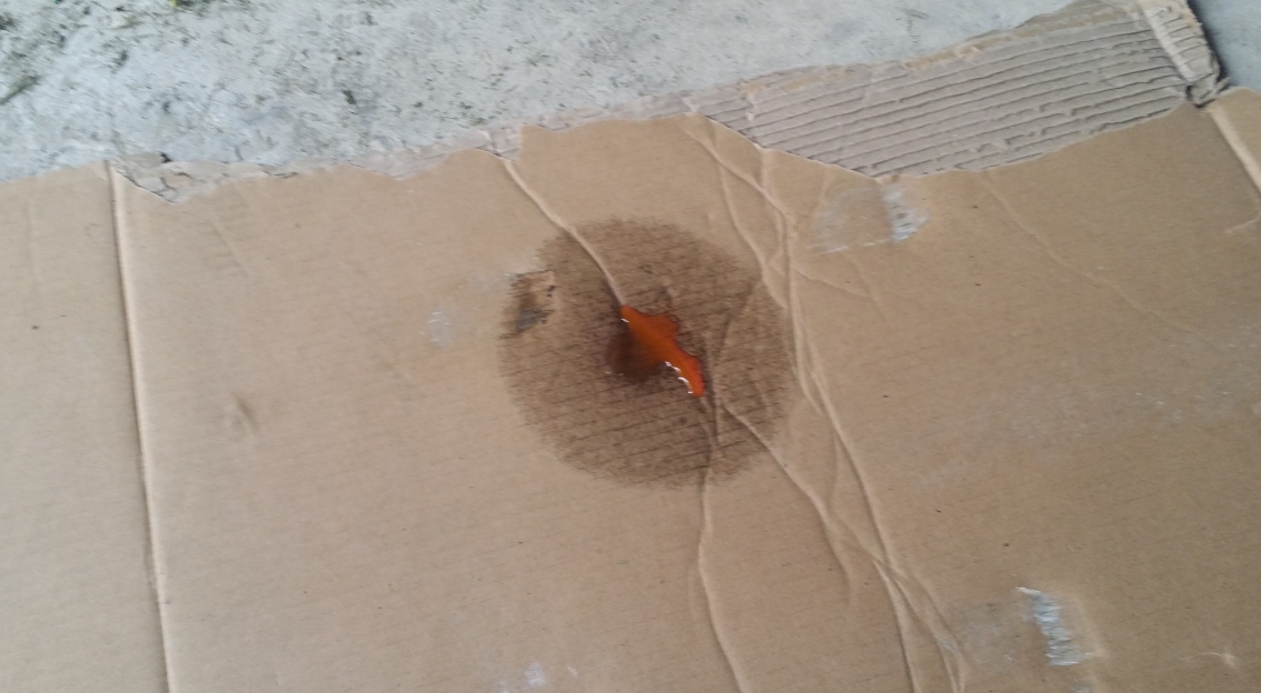

Thanks again. Will just have to monitor the battery but sadly I think I still might have a leak.
Amazingly the next day after the long and wet ride home there was no crud or leaks on the cardboard on the garage floor.
We took the bike out yesterday for about 25 miles or so, parked it up, left it overnight and I went to check just now and there is another puddle right in the same place. At least you can see what it is now with the new orange coolant.
The lads in the garage did say that there might be a bit of coolant spillage to come out and I think they maybe slightly overfilled it but it looks like the same leak to me. Ill just have to monitor it and see if it dries up over the next week I think.

Still another puddle this morning so I cant see how its the pressure of maybe too much coolant pushing it out somewhere. Same spot right at the back and when I started it up there was smoke coming out the panels and around the engine and rear. Presumably spilt coolant burning off. It stopped after a while. Now the flaming centre stand doesn't spring up properly either.
Rode ok though. Did about 10 miles. No overheating and seems fine. Ill check the coolant levels later when its cooled down. Getting a bit disheartened with it all now.

Ok, so Bingo this is not too out of character to find this leak. It's probably nothing other than the new hose clip not being tight enough. What happens is that the 'one time use' very narrow hose clip that was originally causing the leak has now been replaced with a screw type worm drive hose clip. These are difficult to get a proper seal with sometimes because they are much wider than the original factory hose clips. The factory clips are from memory 9.1mm wide but nearly all worm drive screw type are 11-12mm in width. The factory hose clip has made a rut in the hose exactly 9.1mm wide. This means the wider screw type clip won't compress down properly on the hose and they leak. Often re-tightening the clip will fix it but sometimes it won't and you need either a factory one time use clip again, or to use some coolant friendly sealant inside the end of the hose and a little on the radiator pipe. Refit the hose and leave for several hours before refilling with coolant. If you need to do that I can tell you what sealant to use but can't think of the name right now. But it's a special one for this purpose and it's quite widely used in workshops and by diy'ers for this very purpose.
Question: is the coolant leak now as big as it was previously?
Something else to consider is that the radiator might have a small leak which shows up after cooling down, which is the normal way these things go. Leaks like this can be hard to find but a pressure test would help. But if it's smoking a bit from a coolant leak on start up this indicates the leak could be more engine related. Don't panic but watch carefully to see if you can find a trail leading back to the cylinder head or a hose around there. You may need a good torch and some time to check her when she is cold to see where it's coming from. The new coolant with it's more coloured appearance may help.

Thanks for that comprehensive and helpful reply. I think the leak is worse but it could just be that its more obvious because the liquid is orange.
To be honest, I have kind of had enough really. I think the dealer should take it back and have it for a few days and sort it. I have really bad Arthritis and I cant really get down underneath it very well and I am not at all mechanically minded. I have said I will give it a few days to see if it sorts itself out but I dont think it will. I kind of regret buying it now as it was clear it had not been used for a while with the MOT gaps but I do love the bike, its perfect for what I wanted. The excitement after a year of looking has been somewhat spoiled though. Im sure it will get sorted though hopefully.
