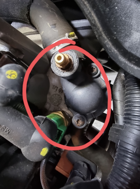

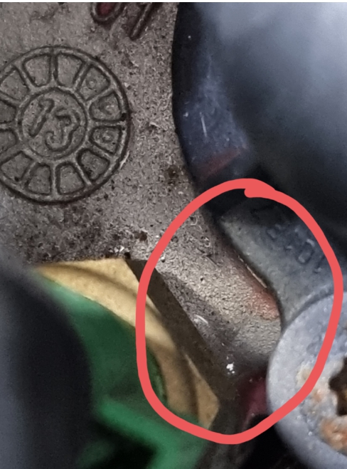

Ill just copy and paste the bulk of the email and the two photos attached.
"Sidestand is sorted. Just needed some more lubrication. Must have just got crudded up and a bit dried out with your ride down here and back the other way and the rubbish weather.
We think we have identified the leak. When you lift the seat and look down on the top of the engine, there is the bleed valve for the cooling system. This is a metal valve screwed in to a plastic housing. The valve itself is not leaking, but it seems the leak is coming from the bottom of the plastic housing. As the bike hasn't been ridden since it was last leaking in your garage, the leaked fluid has blown away or burnt off, so we can see wet areas and tiny puddles of coolant up at the top of the engine right next to this plastic housing. See attached photos.
We are going to order a new plastic housing and gasket, and replace these. We will also at the same time replace the hose clamp that goes on to this housing, as from what you have researched, the original hose clamps can be quite poor.
Will be back in touch once we have an anticipated delivery date for the parts."
Hopefully thats it then. Any thoughts?

As per my earlier post this is a known weak point. I am having some troubles with similar materials on the battery "undercarriage" of my electric scooter, these plastics just do not have enough toughness even though they are strong in compression, and they crack or fail under tensile stress.

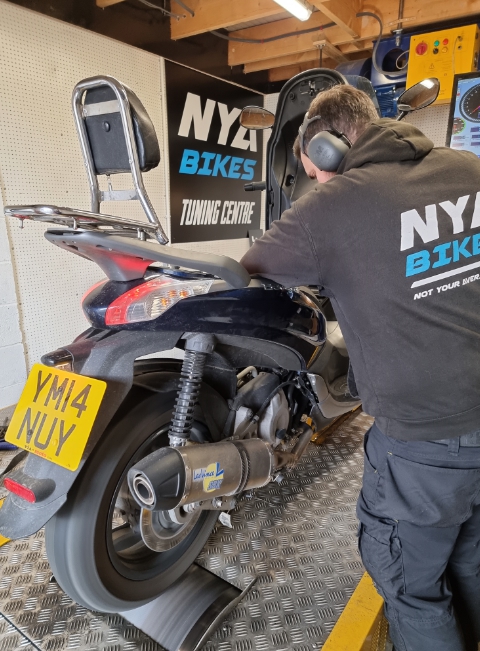

The dealer is sending me live updates now of the testing. Here is the bike being run up to speed on the Dyno just now.
