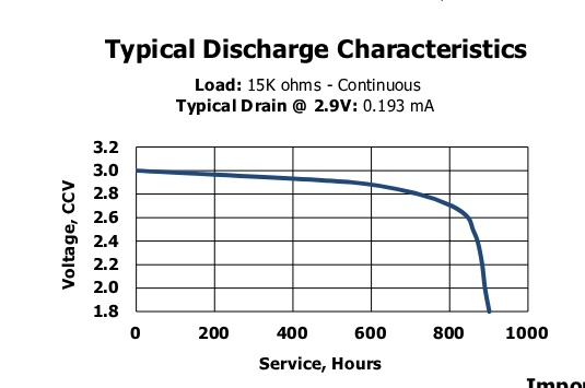

Energizer give a nominal closed circuit voltage new as 3V
An open circuit voltage (multimeter) might be 7% higher, so 3.2V
Not much leeway even in their own numbers?
3V on the bench is roughly 2.86V plugged in, so like battery after 700 test hours and about to drop off the cliff.
Andy
Andy

These batteries work at such low current drain ( 0.193 mA on the interesting graph in your post) that testing them with a typical voltmeter is almost impossible unless it is done in the working circuit. Also given that cheap multimeters are not necessarily that accurate its only possible to use a relative reading to compare batteries both when new and after problems crop up. It is also important to always measure at the same temperature because the ( Lithium ion?) chemistry is temperature sensitive.Andym wrote: Wed Jan 08, 2025 5:22 pm Energizer give a nominal closed circuit voltage new as 3V
Andy
