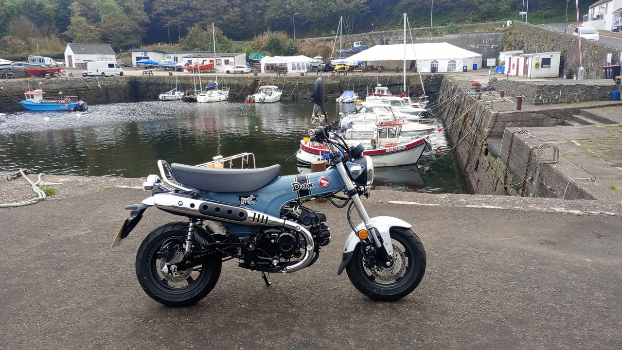

I wasn't really looking for one of these but a pal of mine bought one 3 years ago as a pit bike but didn't get on with it and wanted it gone. He only managed a grand total of 32 miles, half of that round Spa on a non race day and the rest by his race engineer every 6 months or so to keep it fresh. It's definitely had an oil change but whether that's with running in oil or not I don't know. Anyway, I'm just going to ride it however I like. It's quite a torquey little thing and much quicker than I expected and, of course, much fun. Took me half a day to get used to the semi-auto gearbox but I wouldn't say that I'm a great fan of the heel/toe setup on any bike (yet).
