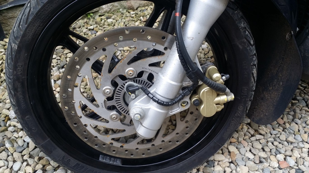

Ok so if you look at the picture in your link early on in this thread, you will notice it has a small bright metal serrated disc mounted near the centre of the wheel on the same side of the wheel as the disc brake. That is the abs 'tone wheel'. Nearby when looking at your bike, if it has abs you will see an electrical sensor almost touching the serrated disc. The sensor is usually covered in rubber and mounted on the fork leg that counts the number of wheel rotations. It's job is to compare the front wheel rotations with the rear wheel rotations to make sure neither wheel is skidding or slipping. If your bike has that 'tone wheel' then you will have abs. But also your instrument panel should show an abs light that flashes after start up until you get your speed above 6mph. Check your owners handbook for confirmation if you are not sure. I'm not a BV "eggspurt" but pretty much all bikes with abs are the same regarding the tone wheel, sensor and stuff. Of course there are lots of other bits of equipment fitted to abs bikes such as the abs pump, but that's hidden and not easy to see. That's why you cannot fit a non abs wheel to an abs bike as it throws your ecu and whole system out of sync if you do.

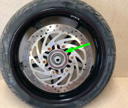

Thanks for those replies. I cant look at the bike right now but will this afternoon. I posted this on Modern Vespa also and someone there said if it has the slotted ring in the center of the brake rotor it has ABS so will look later. This is the one off ebay.

Bingo
Posts: 184
Re: New wheel and tyre BV 350 after near death experience!
Post by Bingo »
Closer photo of the wheel on my bike from the other side. I would say it has ABS. And of course there is indeed the ABS light on the dash.
So do you think that Ebay wheel pictured above is a match?
If it's off a 350, then it should be fine. You need to check that wheel for truth & cracks though. I came to fit a wheel a customer had bought from eBay, to his bike (a Burgman 650) only to find it had a hairline crack in it where a spoke joined the rim. It looked perfect in the photos but these cracks are hard to spot without a detailed magnifying inspection. Seller wouldn't give him his money back, claiming he had caused the crack himself. I wrote a letter for him confirming the wheel had not been fitted to his bike as it was unsafe. Didn't hear what the final outcome was. Sadly that sort of thing is not unheard of so be very careful. Good luck!
