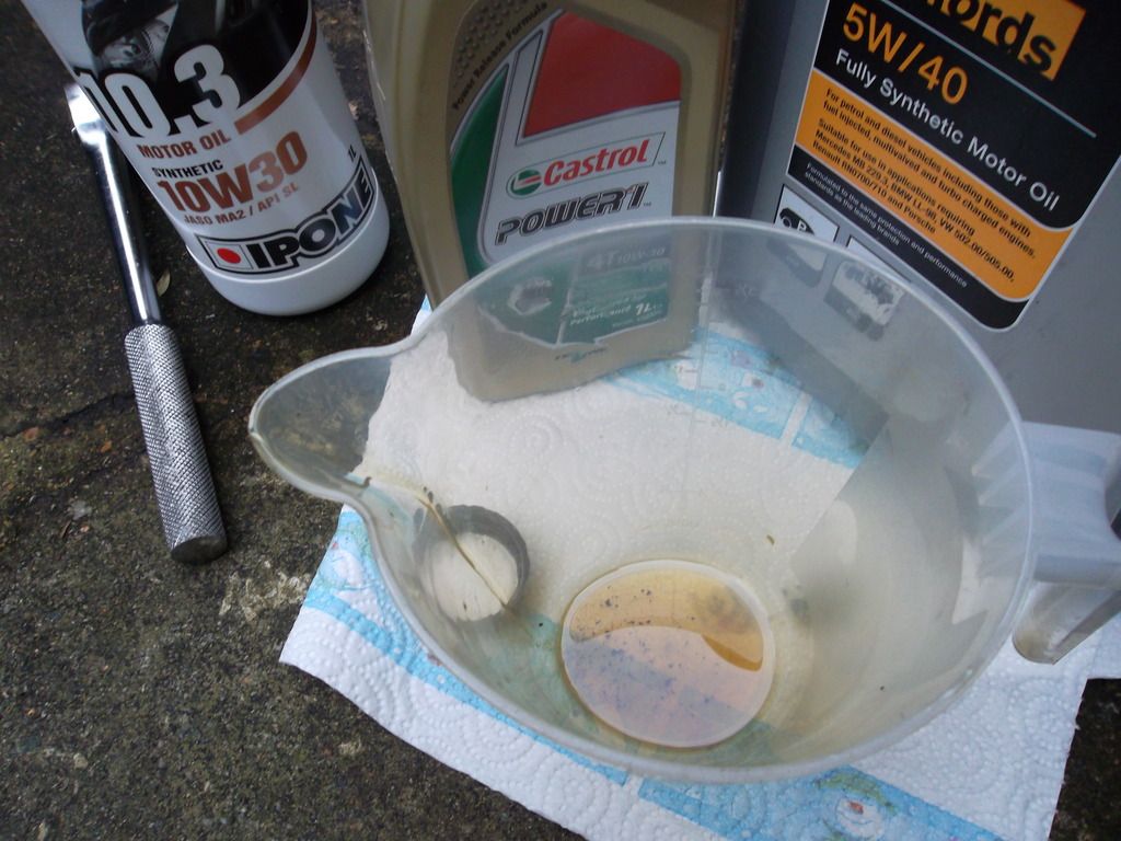

well done the engine and gear oil... with the engine oil took of the large strainer as well, going by the yamaha majesty and versity manuals they say 1.4 ltr yet there displacement is 249cc and 264cc so i was expecting slightly more, i got out 1.65 ltr so thats the amount when refilled + 80ml of ZX1 as well.
the gear oil on said yamahas were 250ml.. mine was 300ml +10 ml of ZX1 and was 80/90 gear oil so thats what i put back in, the owners manual stated 110ml of gear oil and .9ltr of engine oil :roll: :lol: :lol: :lol: im sure that some of the stats in the owners manual are from a 50cc scoot :lol: :lol: :lol:
the large thumb strainer
the bits of swarf that came out of the drain plug, strainer was ok
used ipone 10w 30 semi synth and shell 80/90 gear oil. the castrol bottle is the easy pour empty i use and the halfords is the waste oil container :D
so no gear oil change for a long time and will maybe do the oil at 2000 or so :kiss:
