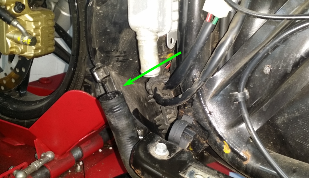

Anyway I got down to the dealers about 11am and they got straight onto it. I just heard they found the leak which they say is a hose on the radiator. Sounds like they will be changing all the hose clamps when they do the coolant flush. Ive not heard if they have inspected the freeze / core plug yet but ill check.

They just showed me the core plug / freeze plug and it looks ok. All of them have commented how good condition it is around the engine. The guy that had it had a collection of bikes and kept them spotless apparently in a heated garage and only dry use.
The leak is well forward on the radiator from where it is dripping down towards the back but they are telling me that its probably tracked through the body work. Its the only leak they have found so lets hope its that.

thats good news! i know that hose clamp well. a few plastics need to come off to get at it! that photo you shown of the engine bay does look that the bike has been kept well!
