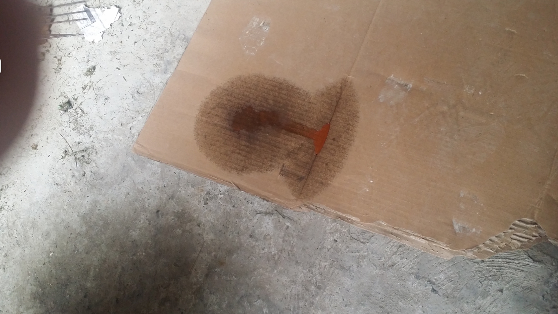

Re: My Piaggio BV350 has a leak!
Thanks. I just went back and looked at your post and video. On the video its just pouring out though. You said in your post after that "This had a leak from that plug near exhaust was very small and sometimes nothing showed , but you could smell burning coolant sometimes ." Are we talking about the core plug there? I think they checked that and it was fine.DTO wrote: Sun May 16, 2021 3:36 pm As posted before the mystery coolant leak was the main reason I traded my 2013 Beverly 350 in for another scooter , But the crappy centre stand was also a pain in the butt , It went very loose and scooter would wobble from side to side on the stand , Ok I thought tighten it up a bit then but this made it seize up , Ok needs striping & greasing up like most scooters need now and again .
Problem with the Beverly is it has O-rings on the end of the engine tube where main stand bolt goes through ( to keep it water tight ) , These wear hence the wobble and doing the bolt up tightly makes it stick . Solutions fit new O-rings ( mine was 3 years old ) or some kind nylon washer instead ?
This is the puddle today after over 24 hours sat in the garage.
I think it was the core plug as looked damp sometimes ?. I never fully found the cause of the leak as it was random and left no trace apart from drips on the floor .
Oh dear. Lets hope its not that. I reckon it needs to be run around, then stripped down completely and left overnight with everything exposed. Then hopefully they will find the source. Should it really be this complicated?DTO wrote: Sun May 16, 2021 8:37 pm I think it was the core plug as looked damp sometimes ?. I never fully found the cause of the leak as it was random and left no trace apart from drips on the floor .
Cover the area around the core plug with talcum powder and leave it to see if any drips occur , then look for tracks in the talc.
Another thought on the leak is that the system should be pressurized when at running temperature and, because I don't think there is a pressure cap on the radiator, pressure must be maintained by the reservoir cap which should have a good seal. These caps can sometimes bind on the thread so they are not actually tight and then there will be some leakage which will be fluid when the system sloshes around on the move. This may only be evident when stopped although it should not continue to leak when not in use. You can check that the system is holding pressure by squeezing one of the fatter hoses after everything is hot. This may also be a way of provoking more leakage to spot where it is from. Also check the thermostat housing area where there is a bleed screw. I have an idea that these are some kind of plastic composite and have been know to crack if the bleed screw is overtightened.
