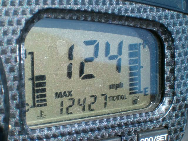

Re: Aprilia SR MAX 300
i'm with you on this one horobags...having said that few years ago my X9 250horobags wrote:I must be getting old!!, top speed isn't that important to me any more,if its reliable, torquey enough to overtake, has a bit of character, and will sit at speed limits, that'll do me.
