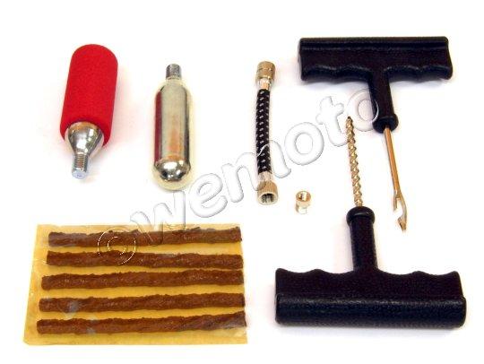

I have had a couple of occasions where a large nail has been embedded, and in one case must have been there a long time and neither time I was aware of picking up the puncture. Both would otherwise have been a rapid deflation. It was only a spot of green liquid on the drive under the wheel gave away the problem, and after a pressure check and top up I just left it alone in one case as the tyre was over half worn, and in the other I simply plugged it with a kit like Capitano has posted.
