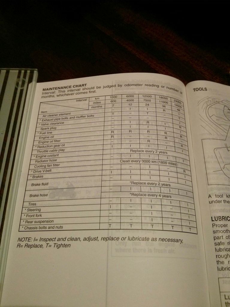

Re: AN400K7 - wots it like?
Here is the K8 400 service schedule which will be generic for those of that era.
