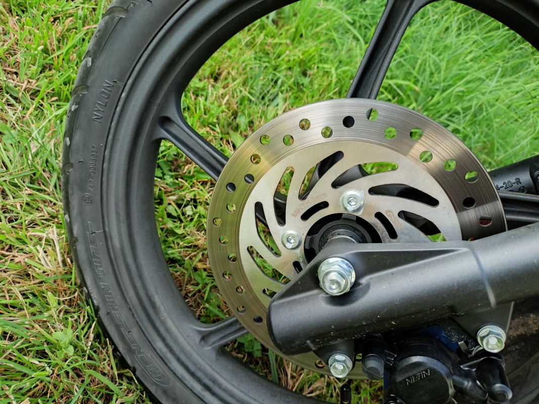

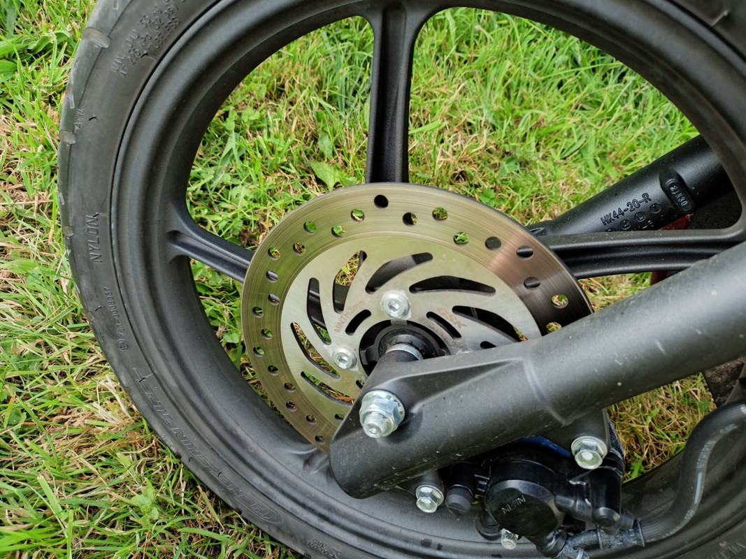

Took some pics. Everything seems solid, nothing loose I can feel or see. Spinning the wheel you can just hear it catch every revolution. It was worse yesterday. I guess I could contact Padgetts and see what they say. Not had the best of experiences with them so far though.

The small stone theory is definitely something which has happened to me. It wasn't in the pads but lodged in the calliper so that it lightly touched the rim of the disk, and of course would be worse when the disc warmed up. Softened tar can produce these bits which stick quite persistently.

Re: Front brake disk tapping (New Honda Vision 110)
Not sure if your front disc is a floating disc or not. If it is you can take hold of it top and bottom and gently rock it too and fro feeling a very slight movement as the disc moves on it's mounts. It has a sprung steel washer with a shouldered bolt that allows some minor movement. Sometimes one of those mounts sticks and has the effect of making the disc run slightly out of true. A quick tug on the top and bottom of the disc, as if you are checking for wheel bearing movement, can produce a result and reset the disc. You need to do this all the way around the disc.

Thanks again. I did try and rive the disk last night when I took the pictures but it doesn't move. It's been ok today. Still a faint tapping. Could have easily got grit or something in it. Been down a lot of gravelly gritty roads.
Floating discs don't move very much, it's an almost imperceptible amount of movement and you have to exert quite a bit of pressure on the disc when pushing & pulling on it. If you do that again all the way around the disc you may find the noise goes away completely. Or, it might just go away on its own anyway. Either way, do as you are doing Bingo. Keep an eye (or ear) on it! Let us know how it pans out.
