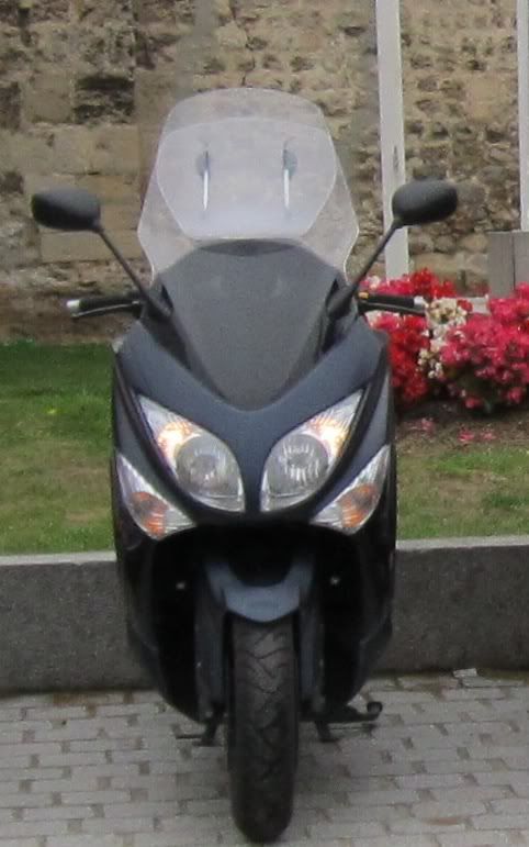

The laminar lip thing is useless for those slightly taller I'm afraid. What you need to do is fit a Givi Airflow spare screen and clamps to your original screen which will require a bit of drilling of your original screen. It works very well....
The parts you need are:
Part numbers are
Z1963R is both brackets and retails at £14.40
Z1997R slidey screen retails at £38.16
Prices have probably gone up

Drill two big holes for the clamps with small holes top and bottom, six holes in total.

The Givi AF screen that is made for the TMAX doesn't work as well.

I had a MRA X-Screen on the standard T-Max screen, it was very good, still a bit of noise but good protection from buffeting. Four small holes had to be drilled to mount it and it comes with a stick on template to do it. The X-Screen has a terrific range of adjustment. I'm 6'3" and found the set up good. I had more problems with legroom though which resulted in me selling the bike.
