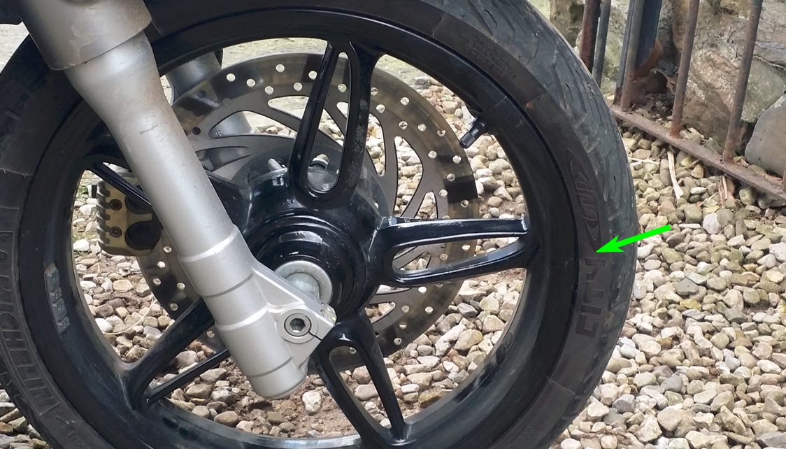

This is my wheel. The arrow points to the slightly damaged area. Do they look the same to you?
Re: New wheel and tyre BV 350 after near death experience!
Yes, replace the wheel and tyre. It's the only way. I'd buy a brand new wheel and tyre. Secondhand can be a nightmare and may not save you money when you realise you've been shafted, as happens often. It's a really important component. As far as I remember the cost of new is very reasonable.

Bingo, assuming you have ABS then you can buy an new wheel from Fowlers online site. Here's the link: https://www.fowlersparts.co.uk/parts/56 ... ront-wheel (note: it has to be ordered from the factory at the moment). May be worth trying one of the big main dealers like Colchester Kawasaki who distribute Piaggio to half the country. Dunno who the North are covered by but it doesn't matter who you order from if you don't go to Fowlers.
It lists the cost further down the page. Pricier than second hand but you won't get shafted like so many people have. You may be able to make an insurance claim for accidental damage caused by that brick in the road. Depends what excess you have as to whether it's worth claiming or not.
Repairs on your old wheel may be viable but you should be aware that repairing alloy wheels is always risky if it's anything more than just the slightest bend to the actual external lip of the wheel. Personnally, looking at your wheel I would not repair that as the shape of the wheel has changed. It's more than just a ding to the alloy wheel lip. Alloy has a nasty habit of cracking and it's never usually the same strength even after a repair. I've repaired alloy wheels for customers myself many times when it's been a minor ding but if the wheel has been altered in shape, even slightly, it will always have a weakness and may crack at some future point. Just saying.
