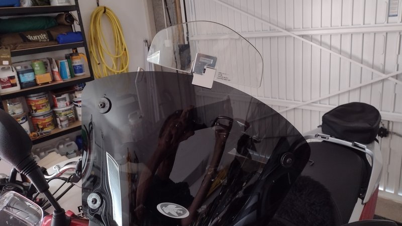

I have the Pyramid Plastics one on my Forza 350. While not transforming the experience, I find a good improvement on the buffetting I was getting. They don't cost that much, so well worth a try.

I have had more success with fairly tall third party screens ( Puig and Fabbri ) which I then trimmed down so that I could just see over the top when normally seated. I've tried various experiments with an additional lip but never found settings I really liked. Third party screens with flared areas providing hand protection have the added benefit of being able to use summer gloves most of the time.

I'm currently experimenting with an old Puig wind deflector on my SH to reduce the noise of the short screen. First ride was poor but improved when I adjusted it to a more upright position. I'll leave it on for a while and play around with the settings although there's no denying that it gets in your line of sight at times.
